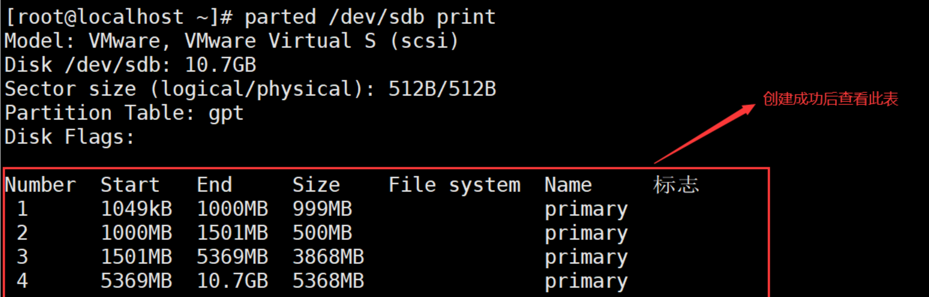

(parted) mkpart primary 0 -1                                              Warning: The resulting partition is not properly aligned for best performance.Ignore/Cancel? I(parted) p                                                                Model: AVAGO AVAGO (scsi)Disk /dev/sdb: 18.0TBSector size (logical/physical): 512B/4096BPartition Table: gptDisk Flags: Number  Start   End     Size    File system  Name     Flags 1      17.4kB  18.0TB  18.0TB               primary(parted) q                                                                Information: You may need to update /etc/fstab.格式化分区
